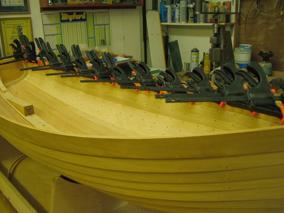

My first question had been how was a transom made if too wide for a single piece of timber - three pieces grooved and fitted with tongues..
Scale-wise it's over thick but as that will not be seen once finished it gives a much better gluing surface
With the keel, stem and transom rigidly secured to the moulds it was time to mark of each mould to give the plank widths. First off a marking board was required to give twelve divisions. A strip of card was marked to the actual length around one side of each respective mould and set to give twelve equal divisions
The each mould was marked both sides.
A 'Rabbet' (A whole new vocabulary was required!) was cut along the edge of the keel for the 'garboard' (see what I mean ;) plank to fit into and finally all the preparation was done and the planking could begin.
After some trial and error, knife and fork trimming the first( garboard) plank is glued and screwed in place
Each plank is a different shape. After that first  plank is in situ  a template is taken off it's edge. This is used to mark the next plank which is cut over wide and fitted in place. It's true width is then marked from the marks on the moulds using dividers or a compass and the marks joined using a flexible batten. The plank is then cut out and used as a template for the matching plank on the other side.
Each plank increases it's 'waviness' the last requiring quite a wide piece of timber to accomodate it. This is the second plank cut out and its opposite number has been marked out.
Simple wooden clamps and the bench top provided an excellent way to hold the planks for shaping. All trimming was done to the line using that small block plane, the chisel and the sanding block.
These little peg type clamps and wedges,seen on the videos were an absolute boon. I had four of the sliding clamps but soon bought another eight and even then I could have done with more  :o
'Each plank was first steamed and held in place for about four hours then glued to the previous one and left to set (Glue used was 'Titebond 3' a waterproof PVA which has an incredibly quick(for PVA) grab time) . Once set each plank was 'rivetted' at 2" spacing
Eight planks down - three quarters of the way in.

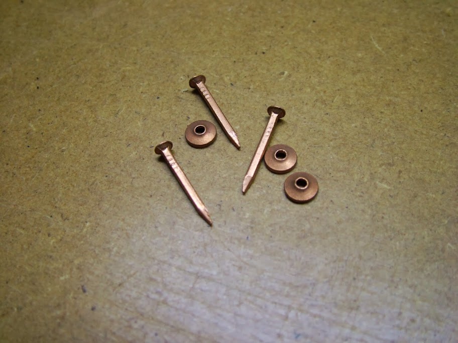

Hi again guys - it's nice to hear all your views and comments - I know this is a bit 'wooden' (oooh!) at the minute but I hope it will be taken as part of the bigger picture - hopefully it won't be too long before it does what it's supposed to and contain a steam engine ;)
I mentioned the 'rivets' - well traditionally, ie fullsize,  the planks are fastened using copper nails and dome shaped washers called roves ...
The nail is driven through pre-drilled holes through the planks from the outside, the rove is then driven, dome outermost, over the nail using a steel dolly to drive it up tight then the nail is nipped off or 'clenched' using nippers and finally peened over the rove. That's a lot of work on any boat and it was just the same here though I cheated a little - well quite a bit I suppose ;)
I bought these nails above  in 1972 - nothing like getting prepared eh  ::) - they and the roves were the smallest available at the time though I believe much smaller roves were one time obtainable. I've always thought that they might be a bit over-scale but would have to live with it however someone set the grey matter working when they suggested using snap-head copper rivets as used for boilers/tenders etc. First thought was that the head would flatten slightly when peening over to 'resemble' a rove but a little work produced a simple punch and die to stamp the rivet head to a more convincing shape ....
If these were inserted from the inside and then peened over and filed off on the outside they might just look convincing enough.
Just how convincing they turned out to be was quite a surprise - more a bit later.
A few were done and a small test piece made to satisfy myself it would work. 1/16 dia rivets were used and surprisingly they worked out just under, but very near to scale  :D For the first time then that home made fly-press actually got to work on a repetitive basis and produced several hundred of these little devils in 1/4, 38. and 1/2" lengths. The 'die' BTW,  actually really an anvil, had a sprung loaded ejector below hence the rivets sitting proud
Every rivet then had to have a point filed on so as to penetrate the pre-drilled holes. Held in needle nose pliers this was done one at a time with a needle file -  quite time consuming, especially when fitting the planks as every one had to be inserted, as said, from the inside and using a mirror to see the hole  ::)
